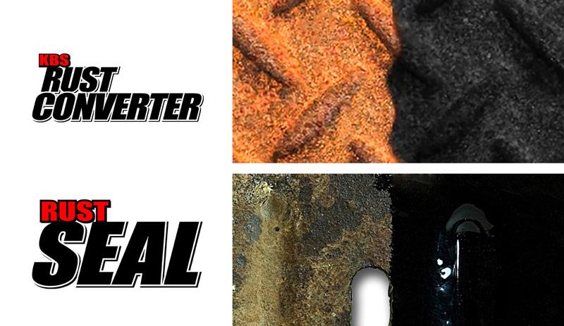

Rust Converter or RustSeal: Which Is Better?
RustSeal is better for a truck frame you plan to keep: it lasts longer, works on rusty and clean steel alike, and leaves a smooth finish. KBS Rust Converter is better when you want to stop rust fast with minimal prep on steel that is rusty all over.
| Factor | KBS Rust Converter | RustSeal |
| Prep | Remove loose rust; clean if dirty | Remove loose rust, KBS Klean, RustBlast |
| Surface | Rusty steel only | Treated rust or bare, clean steel |
| Application | Aerosol | Brush, roller or spray gun |
| Finish | Flat black, coarse texture | Smooth, hard finish |
| Ready for topcoat | 24 hours | 3 to 8 hours, or 24 hours plus a 320 grit scuff |
| Protection | Stops existing rust and primes it | Longest lasting KBS rust protection |
