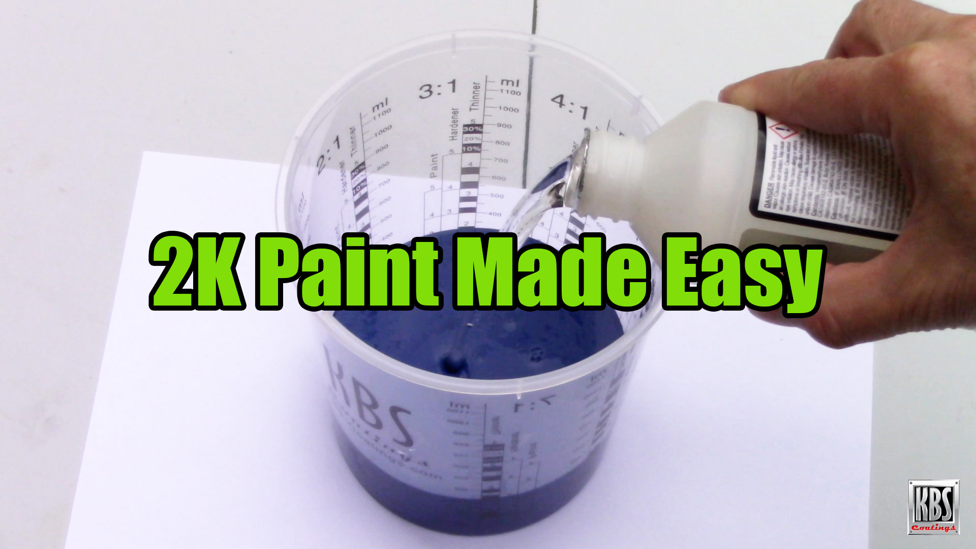

How to Measure 2K Paint and Hardener
The easiest way to measure 2K paint is in a graduated mixing cup with printed ratio scales. The KBS Paint Mixing Cup carries 2:1 through 7:1 scales, a milliliter scale and thinner percentage marks, so you read the amounts off the cup instead of calculating them.
Before you measure, mix the KBS MAXX base thoroughly in its can. KBS MAXX is a high solids coating, and mixing the base well before activation is key to long-term durability and appearance. Use a Hurricane Paint Mixer on a variable speed drill.
Next, find the scale for your product's ratio. KBS MAXX needs three parts base to one part activator, so use the 3:1 scale.
Arrow pointing to the 3:1 mixing scale printed inside a KBS Paint Mixing Cup
KBS MAXX mixes 3:1, so every measurement comes from the 3:1 scale.
Then decide how much mixed paint you need. Use the cup's milliliter scale to find that amount, and read across to the matching reference number on the 3:1 scale. In this example, about 400 milliliters of mixed paint lines up with the number 3 in the Hardener column. You will use that one number for both components.
Arrow marking reference number 3 on the 3:1 scale of a KBS Paint Mixing Cup
For a 400 milliliter batch, the reference number on the 3:1 scale is 3.
Set the cup on a level surface and measure with that same reference number:
  1. Add the paint. Pour KBS MAXX base into the cup until it reaches your reference number in the Paint column. Here, that is 3.
  2. Add the hardener. Pour MAXX Activator until the mix reaches the same number in the Hardener column. Here, that is also 3.
  3. Thin only if needed. KBS MAXX is ready to use as mixed. If your application calls for reduction, add KBS #1 Thinner or xylene at 5 to 10% using the cup's thinner percentage marks. Never reduce KBS MAXX with lacquer thinner. It is not compatible as a reducer and will compromise the finish.
Blue KBS MAXX base poured to the reference line in the Paint column of a mixing cup
Step 1: KBS MAXX base poured to reference number 3 in the Paint column.
KBS #1 Thinner being poured into activated KBS MAXX up to the 10 percent thinner mark
Step 3, optional: KBS #1 Thinner added to the 10% mark on the cup's thinner scale.
