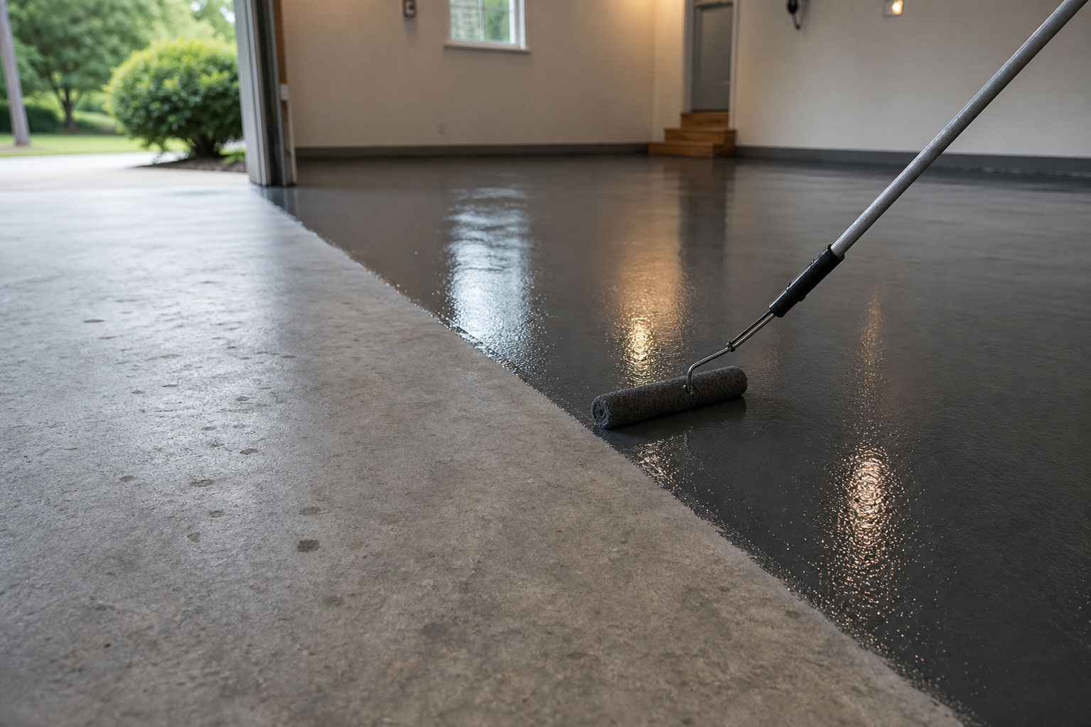

RustSeal as Concrete Floor Paint
RustSeal is a single-component moisture-cured urethane best known as a rust preventive coating, and it bonds to concrete just as well as it bonds to metal. Its thin viscosity lets it penetrate the pores of the slab, then it cures by pulling moisture out of the air and interlocks inside those pores. The result is a rock-hard, non-porous barrier that resists abrasion and impact and will not crack, chip, or peel.
Concrete floor sealed with RustSeal concrete paint
When to Use RustSeal on Concrete
Use RustSeal on concrete that does not get regular direct sunlight, such as an indoor garage, basement, or shop floor. RustSeal is not intended as a final finish under UV exposure. Its rust and moisture protection hold up fine, but the color and sheen can dull over time in the sun. For a floor that sees regular sunlight, use KBS MAXX instead.
RustSeal is also the simplest of the four to work with. It is a single-component (1K) product with no mixing ratio, no activator, and no special equipment. Stir it thoroughly for 3 to 5 minutes and roll it on.
