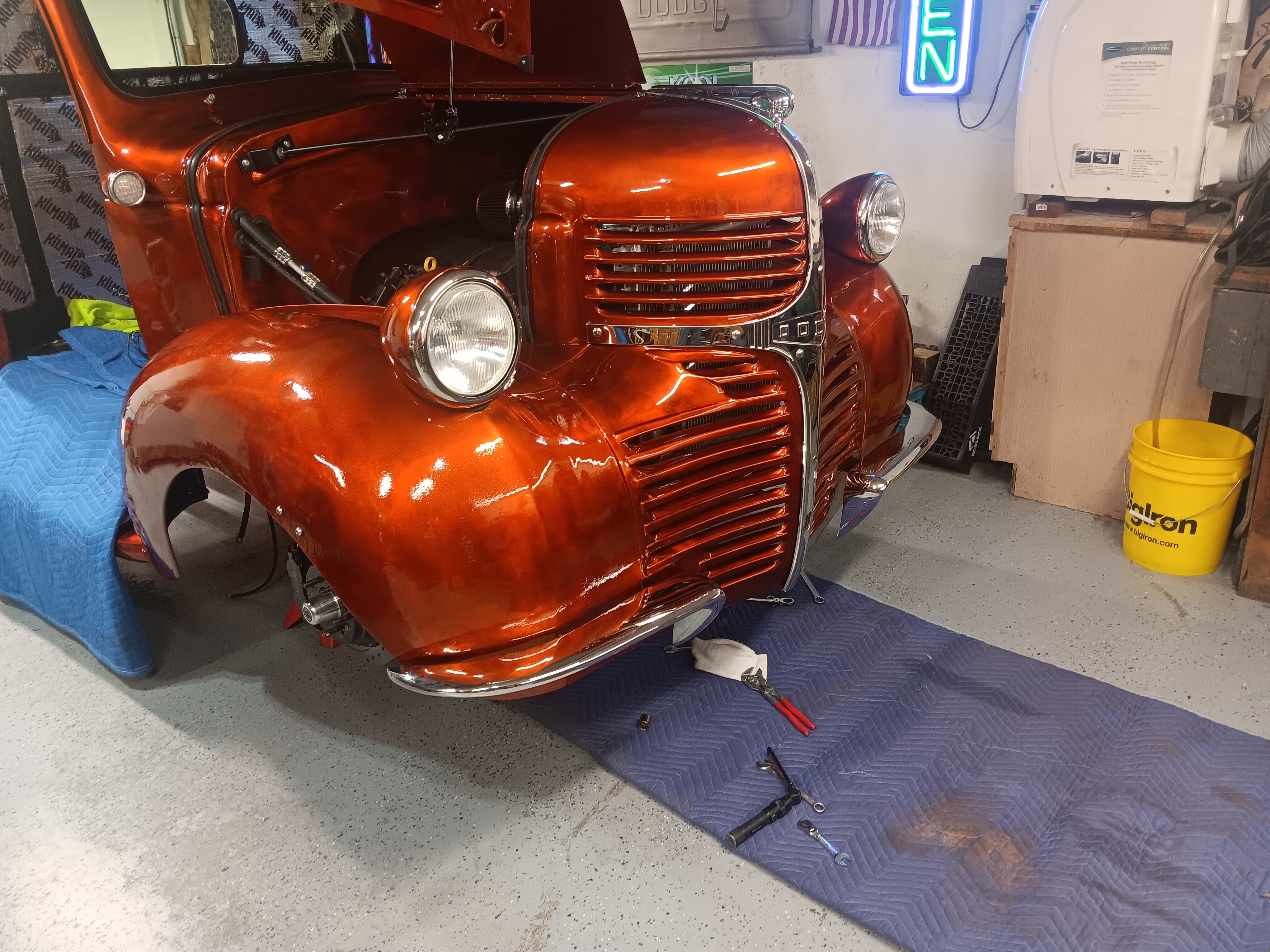

- Automotive and Truck
- Custom refinish over cured basecoat, steel and plastic bumpers, aluminum fittings, tank exteriors, chassis hardware, cylinder heads, engine blocks, brake components, and inlet manifolds.

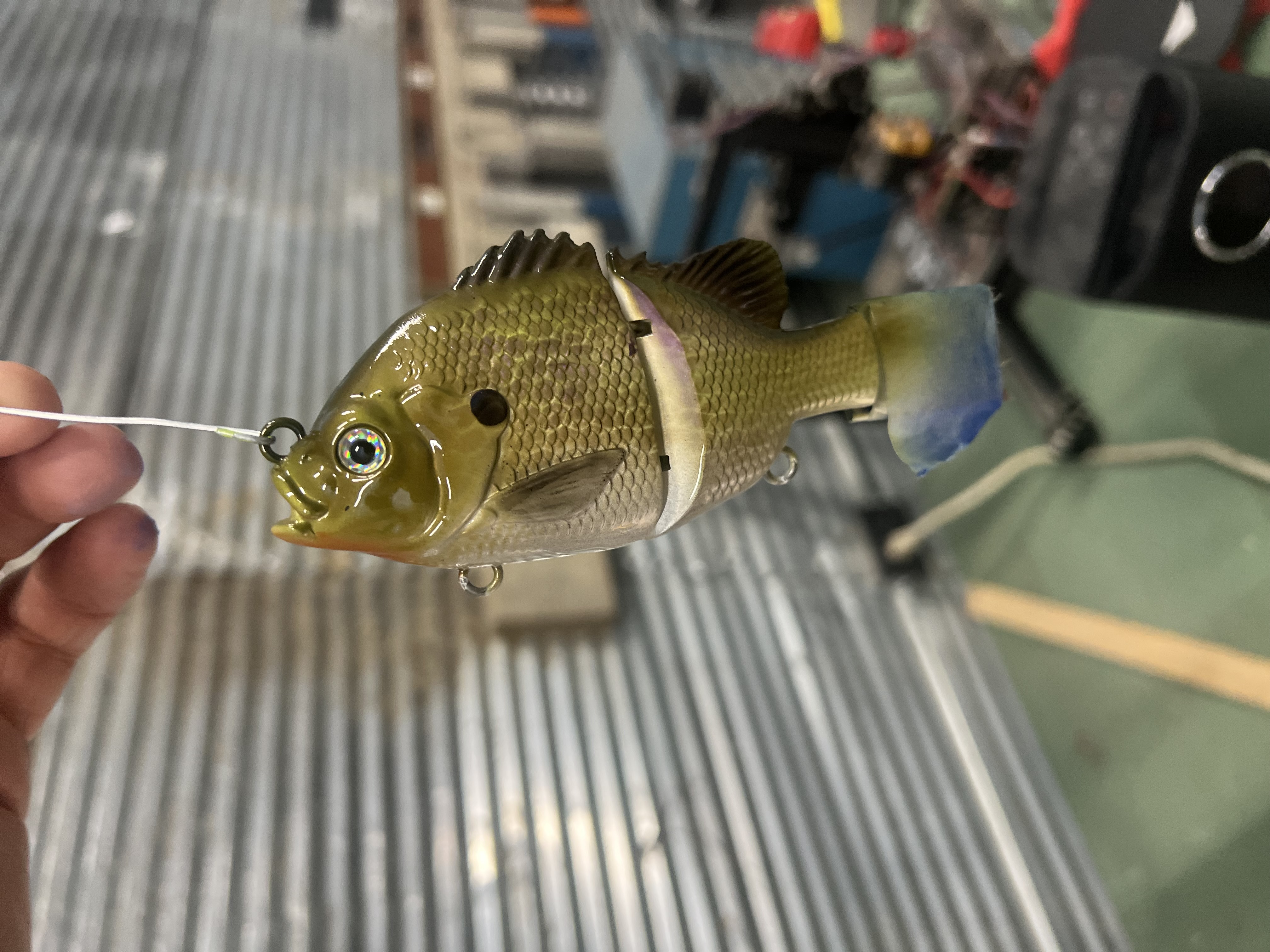

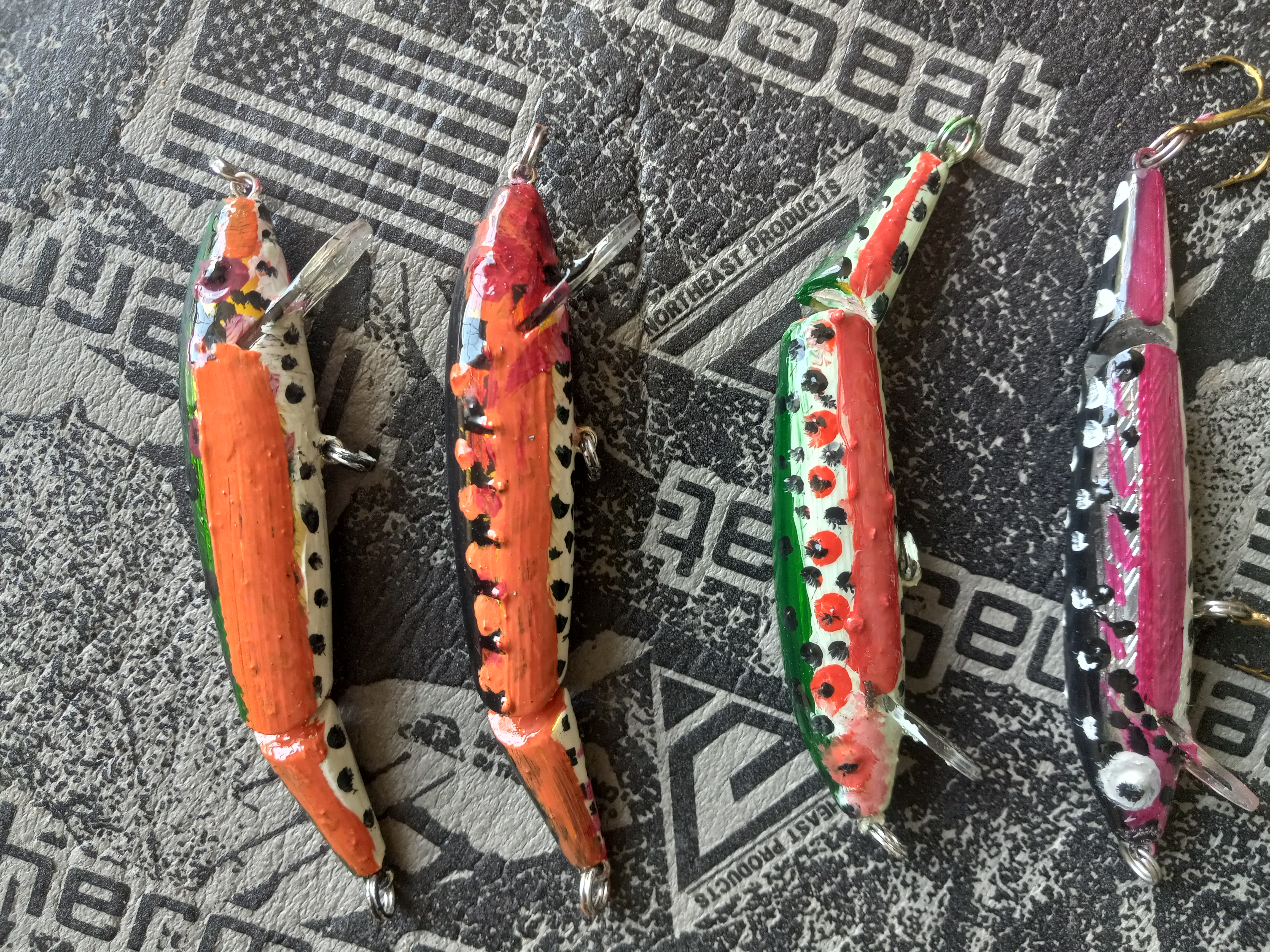

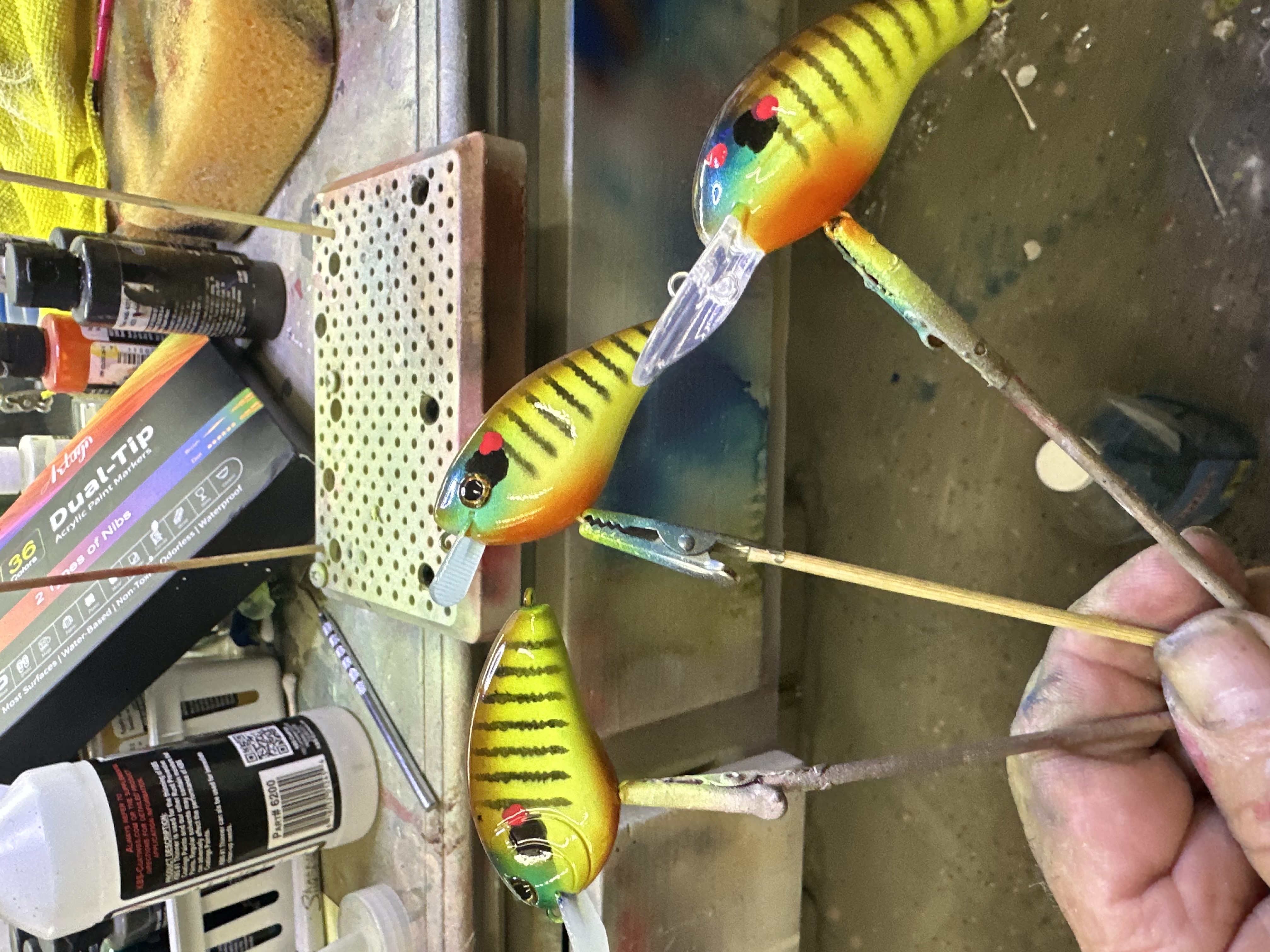

- Tackle and Craft
- Fishing lures, crankbaits, and jigs, plus tumblers, coasters, and custom artwork. The film is hard enough to resist hook rash and flexible enough not to chip on a strike.

Lure bodies can be dipped or brushed, and the film is fully waterproof once cured.
