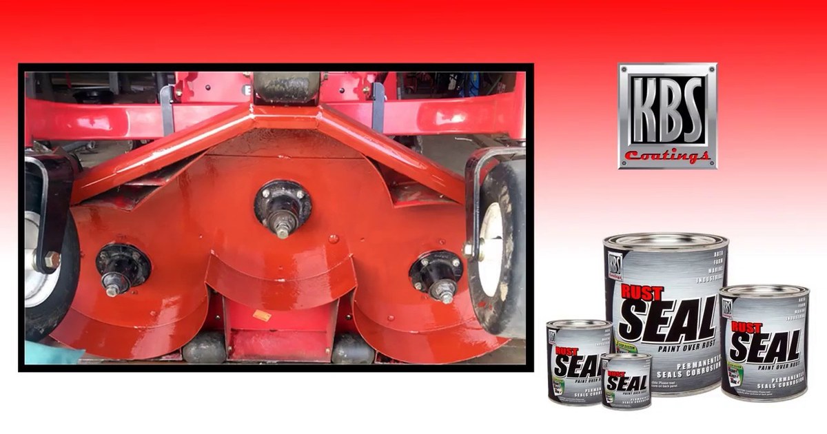

How to Paint the Underside of a Mower Deck
Strip the deck, degrease it, etch it, then seal it with two thin coats. The whole job is the KBS 3-Step Rust Prevention System run on a mower deck: KBS Klean to clean, RustBlast to etch, and RustSeal to seal. Plan on a weekend, most of which is waiting between coats.
1. Disconnect the spark plug and get under the deck
Pull the spark plug wire before the deck goes anywhere. Tip a push mower onto its side with the carburetor and air filter facing up so fuel and oil stay where they belong, or drop a riding mower deck and slide it out from under the machine. Working on a deck still bolted under a mower is the main reason these jobs end up half done, with the skirt and the back corners never properly reached.
2. Scrape and strip the underside
Scrape packed grass off with a putty knife, then take loose rust and failed paint down with a wire wheel, 320 grit sandpaper, or abrasive blasting. Paint that is still firmly stuck can stay, scuffed with 320 grit to give RustSeal a tooth to grip. Light surface rust can stay too, since RustBlast treats it in step 4. Only the loose, flaking material has to come off.
3. Degrease with KBS Klean
Mix KBS Klean with hot water at the dilution the label gives for your level of contamination, scrub with a bristle brush and a Scotch-Brite pad, then rinse and dry completely. Grease and oil left on the metal are the most common reason a coating lifts later. KBS Klean rinses clean rather than leaving a film behind. A household degreaser usually does not. Follow the KBS Klean directions for dilution rates.
4. Etch the metal with RustBlast
Spray RustBlast on and keep the surface wet for 30 minutes to 2 hours depending on how bad the rust is, scrubbing with a Scotch-Brite pad as you go, then rinse and dry thoroughly. A whitish zinc phosphate residue is left behind. Leave it. It prevents flash rust and is part of the profile RustSeal bonds into. See the RustBlast directions for full application detail.
5. Brush or spray two thin coats of RustSeal
Stir RustSeal from the bottom of the can to the top, then apply two thin even coats between 55 and 82°F, out of rain and high humidity. Recoat once the previous coat is dry to the touch, usually 2 to 6 hours, and get the next coat on within 8 hours. If more than 8 hours pass, wait a full 24 hours and scuff with a 320 grit Scotch-Brite pad before recoating. For spray application, reduce 5 to 10 percent with KBS #1 Thinner. Thin coats flow out and self-level. A thick coat sags and skins over before the film underneath has cured.
6. Let the deck cure before you mow
RustSeal is fully cured 24 hours after the final coat, so wait that long before you bolt the deck back together and mow with it. Cutting on a green coat drives wet grass and sand into a film that has not finished hardening, which wears through the work you just did. The full RustSeal directions and technical data sheet cover application detail beyond what fits here.
