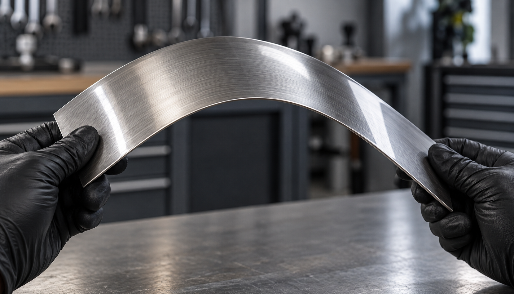

What Makes DiamondFinish Clear a Flexible Clear Coat?
DiamondFinish Clear stays permanently flexible as it cures, so the film moves with the metal instead of cracking off it. It survives 160 inch-pounds of direct and indirect impact and reaches 7H pencil hardness at seven days, which is a hard film that still takes a hit.
That combination matters on metal that flexes, vibrates or sees temperature swings. A coating that is hard but brittle chips and cracks. DiamondFinish Clear is built to do neither, and it needs no hardener or activator to get there.
